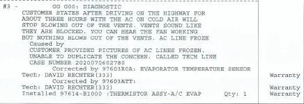

Maybe this can help you guys get the issue resolved.
Here's the Repair Order that seems to have fixed the issue on my 2019 G80. I've put about 2250 miles (a few sustained highway runs) since this repair and the AC has worked like a new car! Oh wait, it is a new car. :giggle:
Car has about 28K on the odometer now. Note that there is a Case Number listed as well as the part that was replaced.

Since the repair shown in my previous post I've taken a couple of 200+ mile "runs" in the Northeast and no further issues. Now at 29K on the odometer.

I bet would still be the AC evaporator thermistor (temperature sensor).
Thank you. I sent the a picture of the service report to the dealer. Will see what they do.

See post #61. Print it out and take it to the dealer. I only had it happen on one trip after about 150 miles at around 70 to 74 degrees. Never happened in higher temperatures, the day before I drove over 800 miles and it was 90 degrees or so.
Update to Post #61: AC continues to operate fine with no further issues, odometer is >33K now.

I replaced the AC evaporator thermistor (temperature sensor) 2 months ago.
no further issues.

It's not a flapper or door that it getting stuck. It's the evaporator that is freezing over and blocking all airflow.
I remember many years ago (I’m old) when the evaporator would freeze up, vapor fog would blow out the vents. Rather than waiting for the ice to melt, I’d just switch on the heat. That would melt the ice fast, then turn the a/c back on.
Show Post #61 of this thread to the Service Manager. Seemed to fix the same issue on my 2019 G80 3.3T
