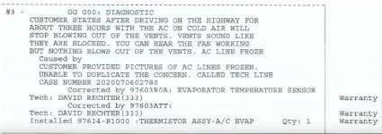

Maybe this can help you guys get the issue resolved.
Here's the Repair Order that seems to have fixed the issue on my 2019 G80. I've put about 2250 miles (a few sustained highway runs) since this repair and the AC has worked like a new car! Oh wait, it is a new car. :giggle:
Car has about 28K on the odometer now. Note that there is a Case Number listed as well as the part that was replaced.

Went back and retrieved the thread: 391503 Attached a copy of the work order from the originator of the thread:
It won’t let us open this. Can you send post a larger image or tell us the part?

UPDATE: Got the thermistor replaced and has worked fine for over 4 months now. Many longer trips taken without issue.

It's a $15 part and accessing it on the 2018 G80 is from the glove box, so the entire dash does not need to be removed, btw.
