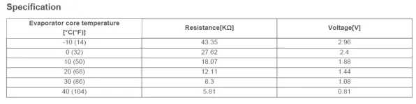

This forum reports that some of the replacement thermistor's were bad. I'm going to ask the dealer to test the new thermistor before starting the repair. A quick 5 minute test is to see electrical resistance change through the thermistor while heating or cooling the thermistor.

This weekend I tested my thermistor. It was relatively easy to remove the thermistor. Remove the 2 round disks (counter/anti-clockwise I recall) on the interior of the glove box and disconnect the "soft opening" arm on outside right of glove box to lower/drop glovebox. This will give you access to the thermistor on the left/engine side of the glove box compartment. There is a metal bracket which makes it tough to get your hand on the thermistor. Be careful so you don't cut your self. I removed the connector and twisted the thermistor counter/anti-clockwise about 90 degrees.
I heated water to 104F and gradually added ice checking the resistance on the thermistor as water temperature decreased. It was in specifications (see post #110 above) from 104 -> 50F. Below 50F ohm-meter showed an "open" reading. This indicated to me the thermistor is faulty.
I plan to purchase a replacement part and test before replacing as there are reports in this forum on replacement/new thermistors also being bad.
Correction/retraction.
I have an OLD multimeter (very reliable/still works) that does not have auto ranging. Initial testing was done at 20 K-Ohm maximum. When the thermistor resistance increased >=20 K-Ohm at around 49F the multimeter showed open/out of range. This was not a part, multimeter failure, but a an operator error. It's frequently the carbon life form behind the keyboard not the computer that is the root cause of a problem ;)
I re-ran the test with multimeter range at max. 100 K-Ohm and the resistance was in specification between 39F and 100F. I couldn't easily test below 39F. I didn't want to stick thermistor and multimeter in freezer. ;). I have gotten rather proficient at removing/re-installing the thermistor having done it 3->4 times.
For now it appears my thermistor is working properly and I will monitor for the issue going forward. I rarely see the warm air/reduced airflow, because I don't drive with A/C on for 2->3 hours continuously very often.
