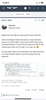

Most service departments of any brand do not care when you mentioned information you got off a forum, my guess is it intimidate them.Genesis customer service FAILED again. I had an appointment to have a field service engineer be at the dealer to check and resolve the AC problem. It had to be changed since the rep had surgery so, no problem, delay. I notified Genesis of the new date and they thanked me for letting me know.
So, I go to Gettel today and, they know nothing of it. No field service, no nothing. Customer service never notified anyone. The service manager will do nothing for me as he does not think it is the thermister. Of course, he does not know the real problem, just keeps insisting it is not the part I suggest.
Twice they spend time checking thing to no avail. In the time spent it would have been much cheaper for them to at least pull the thermister and check it with some ohm reading but no, nothing. I have the specifications but he did not even look at them. He does not think a forum knows anything in spite of the fact that many here had their problem solved.
I emailed customer service but if typical, it will be a long time to hear back. Certainly not a luxury experience with a luxury automobile brand. I have a 2500 mile trip coming up in a couple of weeks and it would be nice to have climate control.
A copy of this post will also be sent to both parties so I'm not going behind their back but everyone should know of the inability to properly fix their cars and keep a long time Hyundai/Genesis customer happy.
To Be Continued. . . .
Is there another dealership that you could take your car to. I have seen this problem with an evaporator coil leak which will cause the A/C compressor in the engine compartment to freeze up which will cause little to no A/C flow from air vents in the car. Once the compressor thaws A/C will resume in the car. Low refrigerant can also cause this problem. Genesis is the first I have ever heard rain being involved.
I would definitely reach out to a service manager at a different dealership. I had this issue with a New 2017 Cadillac CT6 it took a year to get it resolved. It could have been resolved a lot faster if only the service manager had paid attention to information that I provided from the Cadillac Owners Forum much earlier. The problem was the gasket in the A/C evaporator coil was not seated properly causing the refrigerant to leak which caused the compressor to freeze up. Once repaired everything was good to go. The entire dash down to the carriage had to be removed to make the repair.
