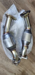

Lap3 primary downpipes with HFC's. They are beautiful, and I wish I had a shop nearby that was experienced enough to install them. It's above my level of comfort.
Lap3 primary downpipes with HFC's installed. They are beautiful, and I wish I had a shop nearby that was experienced enough to install them. It's above my level of comfort.

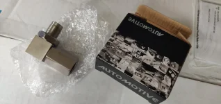

Did they come with the antifoulers?

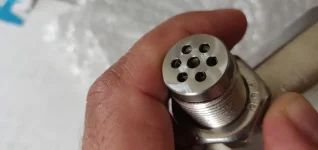

I ordered antifoulers separate. These ones I got actually have a mini-catalytic converter inside them. Pretty sweet, take a look...
If you can take your car apart to remove and re-install the turbo, I would think this would be easy! Is there something that makes this hard?

Oops, I meant that the HFC's are installed on the downpipes - not on my car. Sorry!! I'm gonna sell them, not install them.

What are antifoulers? Do I have to have them?
Antifoulers prevent the CEL o2 sensor code. It fools the secondary O2 sensors into thinking your catalytic converters are operating normally.
These are useful when using HFC's, or removing the cat altogether. Even though HFC's usually prevent an o2 code from happening, it is still not as efficient as the stock cats, and on certain occasions it could still throw an o2 sensor code. The antifoulers eliminate that completely.
