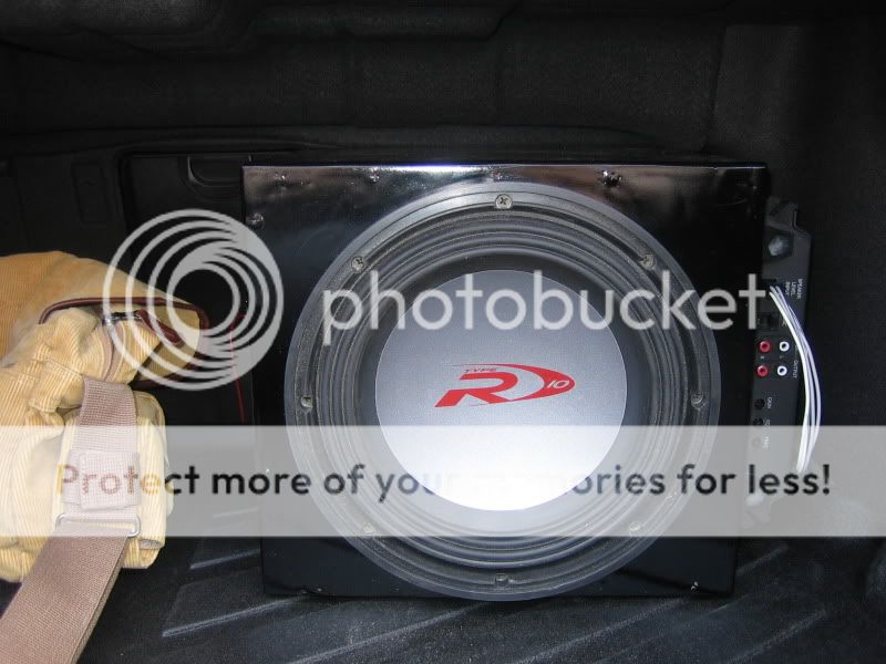

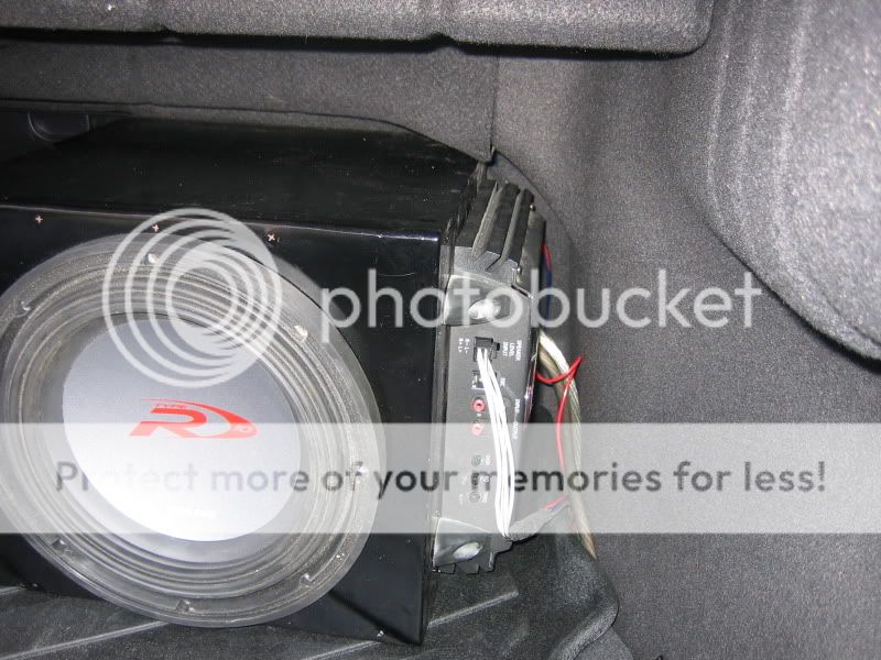

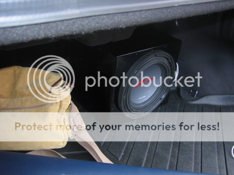

I have added a 10" sub and a small amp to see how I like the added bass without tearing out the stock system.
Still playing with the gain and whatnot on the amp to make it blend in with the system.
Dan
Thanks for the pics!
