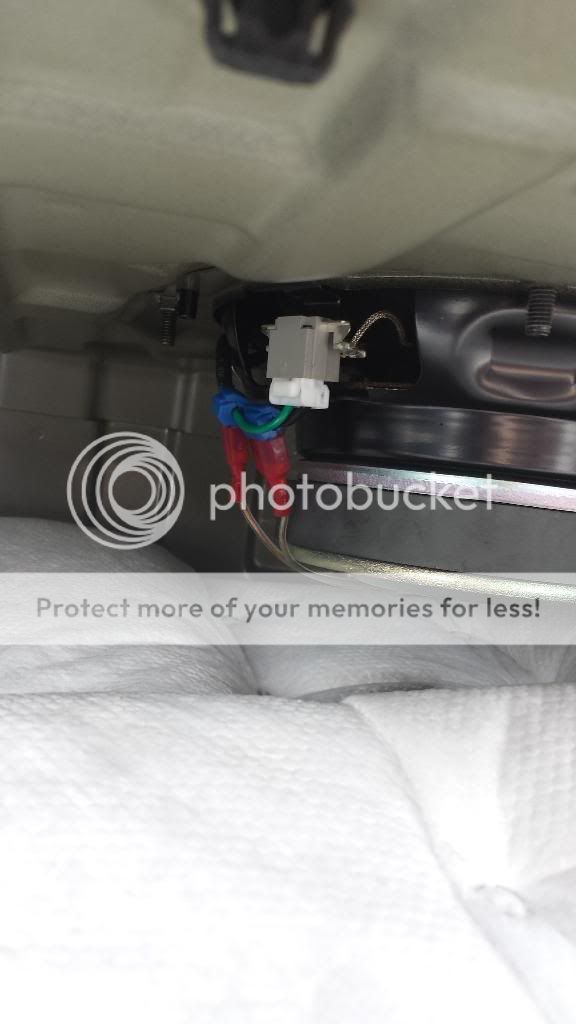

Alright guys, just setup my amp today. Connected the LOC from the amp plugs. In my car they are four cable to the sub woofer.
Which is the top plug/ black on the amp. Yellow/orange/brown/black wires.
I tapped into a wire tech line recommended for me but it didn't work. I'm still looking for a remote wire by the amp.
But I plugged everything up and it works great.

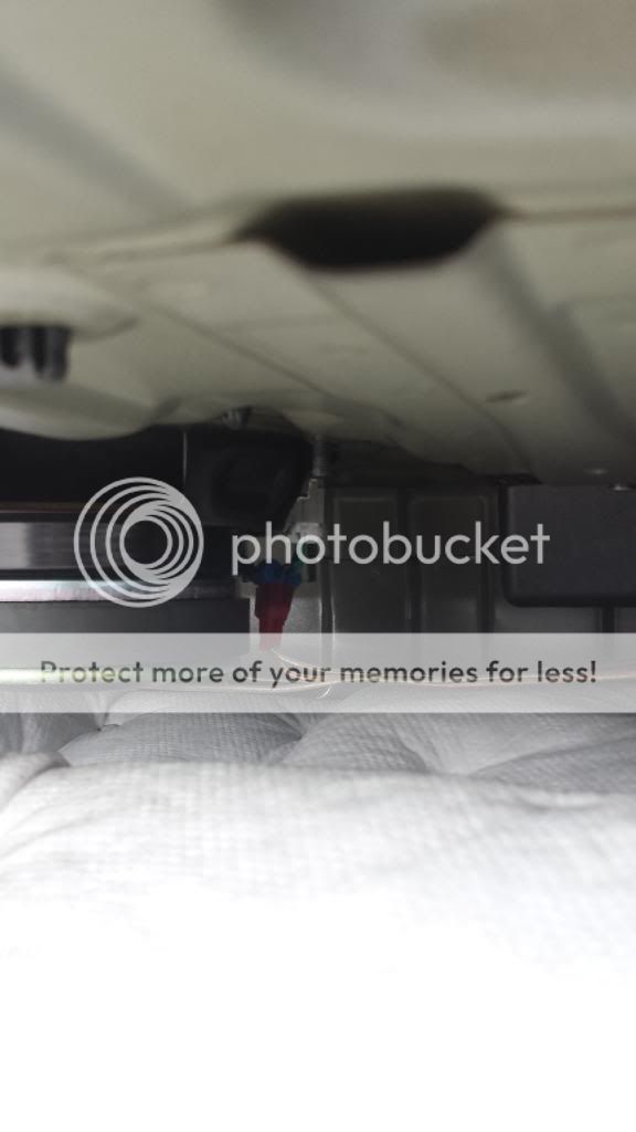

Pulled weather strip, drop roof top, snapped on speakers, ran down side. Less than 5 mins
I tapped into the amp for woofer output. Pulled the right side panel to the side, found my yellow/white/brown/black wires all together. Went to the driver door fuse box for remote. Top left fuse, audio ign. Bought an "add a circuit" from auto parts. Connected my amp.
