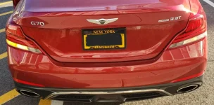

Thanks for this post! I took your advice and purchased the bulbs you listed, and even did the sharpie marker thing. The final product is awesome. I haven't had any hyper flashing either, tested for 5 mins and stopped watching after that.
You really don't realize the difference the LED bulbs make until you compare side by side.
I uploaded a picture to show the difference.
In the picture, the left side is LED whereas the right is regular.
