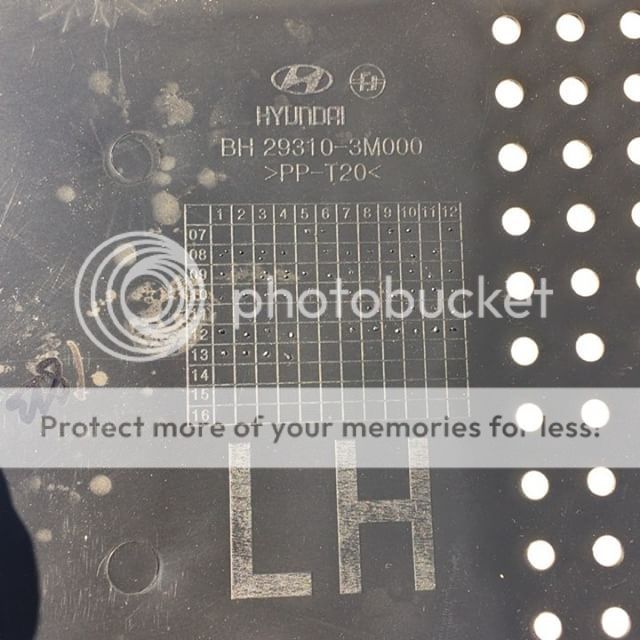

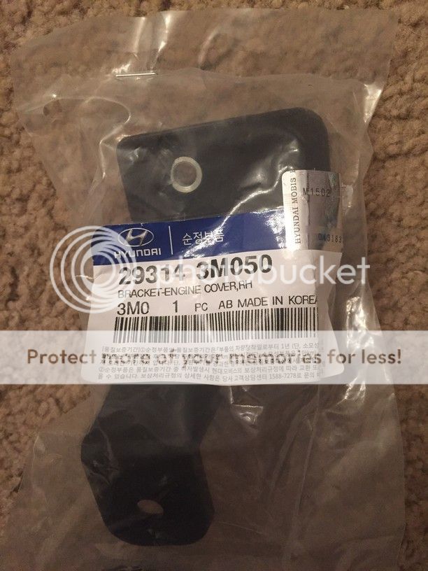

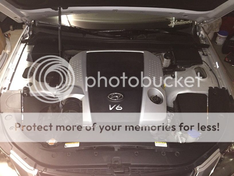

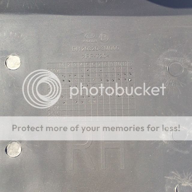

I have purchased the correct Prada Covers, Bracket and installed them without issue. Thanks to Instagram user Nevertroll who was nice enough to send my the part numbers. We both ordered them from KDM Motors. You could reach out to them to see if a group buy is a possibility. If you contact them tell them I sent you their way. Definitely makes the engine bay look way cleaner.
Part numbers:
BH 29310-3M000 - LH Cover
BH 29320-3M000 - RH Cover
293143M050 - Bracket Engine Cover RH

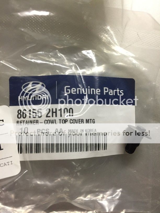

86155-2H100 - Retainer Cowl Top Cover Mtg - (8x) Get these at your local Hyundai dealer or cheaper off Amazon

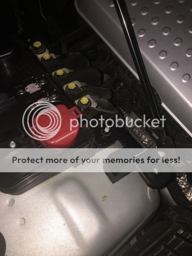

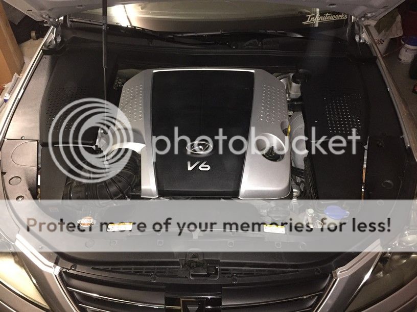

Installed Pics

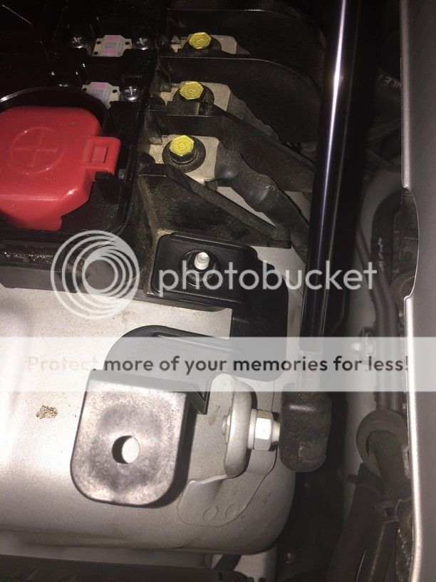

There is a small 6" long piece of rubber weatherstripping that needed a slit down the middle on the bottom to sit flush with each side covers. There is no off the shelf bracket for the LH cover since our cars did not come with dual hood struts. I purchased an extra RH bracket and will be modifying it to fit. Will post more pics when this is installed.
Nevertrolls Engine Bay with Prada Engine Cover:

Have yet to install the bracket on the other side but had planned on putting a spacer underneath the bottom of the mount.
