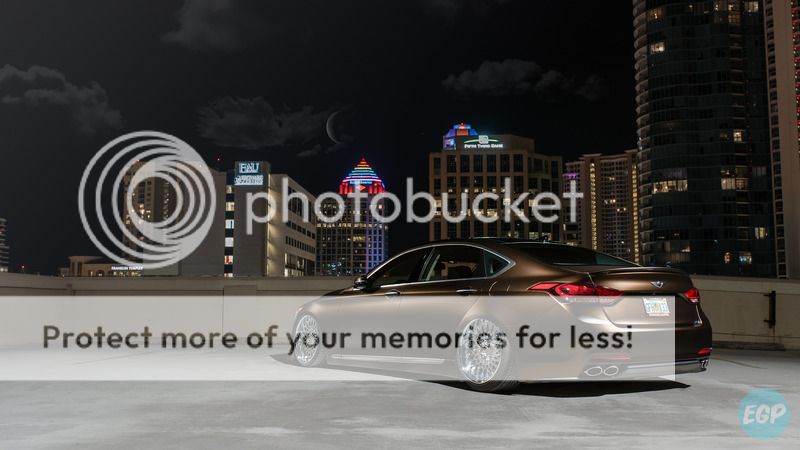

Here's my bagged 2015 5.0
Wheels are 20x10 front plus 3 and 20x11 "0" offset
Thanks for adding pics of your car to the thread. Looks amazong and would love to be able to see it in person sometime. Pretty sure your running AirForce Suspension but if you could add some more details of your build that would be great.
