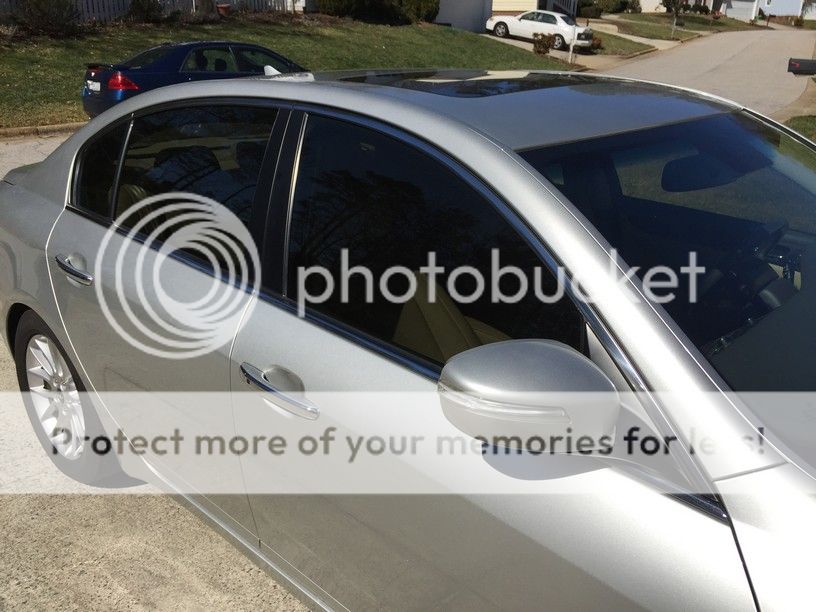

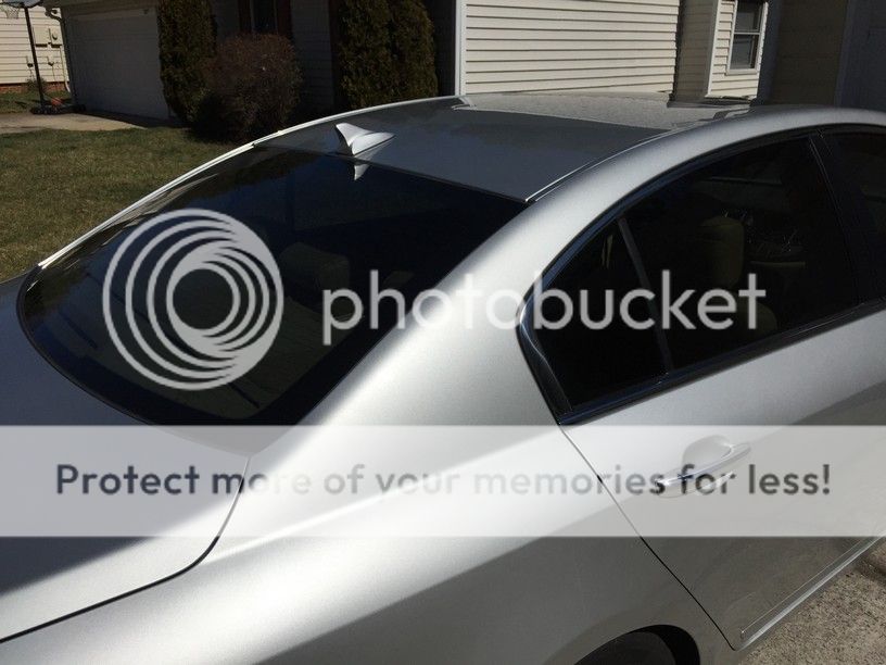

Got my windows tinted with Suntek HP Bronze 40% the other weekend and it turned out great. Pictures don't do it justice, looks more bronze in person.

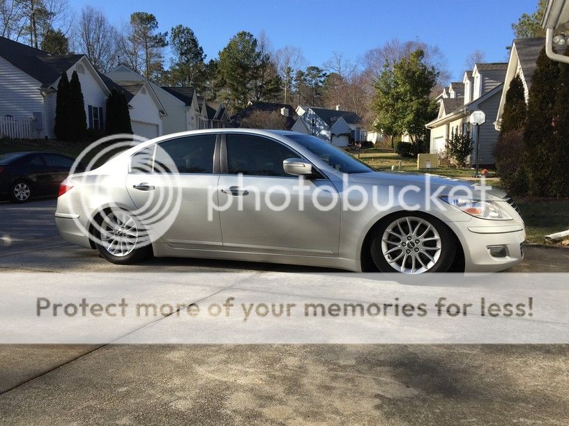

Wheels aren't on right now so I cant measure for you but its very close, a mm or two would be my guess. Keep in mind I had the front fenders slightly rolled so I could drive with about 25.5-26.0" off clearance from ground to top of fender lip. Pic when test fitting to give you an idea.
im trying to dial in offsets so i can build some wheels definitely want to go 20s cause i test fit my 19s they look to small. i want the front wheel lip to kiss the front fender, judging by your rear offset your rear is poking a bit correct and if you air out all the way it will touch the Qtr?
Slight poke but am running 2.0° of camber. You can get around 3.3-3.5° with the factory eccentric bolt which might be enough for it to tuck but can't say for sure. My rear offsets are slightly less aggressive than VipdOut's, 10.5+28 compared to 10.5+25, and his tuck with a slight fender pull. Pic when test fitting to give you an idea, had camber maxed out when I took this picture. Also not a 100% representation of fitment since I jacked up the wheel with the car on jack stands instead of lowering the car and wheels onto wooden blocks.

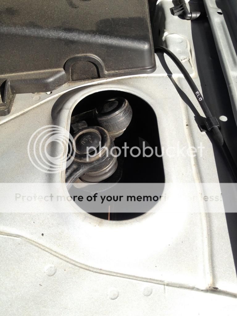

Yes, upper control arms bottom out on access hole in engine bay, have some nice indents now. Plan enlarging this hole once my Prada Side covers get here and will cover up the access hole.
