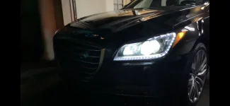

Teaser till I get good video
Looks good. Very bright. Seems to be at the least twice as bright as the amber 2357 bulbs I am using. I personally will not spend $100 for DRL light bulbs, but those bulbs you have do seem like they are worth the money for anyone that will spend that kind of money for DRL bulbs.

So why do the signal/DRL LED looks bright white with the headlights on in one video and only amber as DRL/signal in another video? Do the color change depending on day or night?
The whiteness you see is reflection from the parking lights/headlights. The turn signal/DRL is not on. There's just nothing yellow in the reflector to color the light, since the LED is black/clear when off.
18348
So only a reflection.:(
I thought that it would be very cool for the lights to change color depending on the headlight mode.
Very cool looking light setup regardless.
