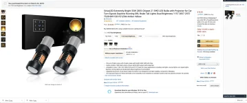

I take it the model linked below won’t work as a plug and play direct fit without mods? Looking for a switchback option without modifications
Won't know for sure until you try it, but it does say "5w" and "Requires hyperblink fix (resistors or flasher)" right there in the description, so yes, it will likely hyperblink.
I'd suggest getting the Sirius CK series (since the CANBus-enabled Huizen that I use is unavailable on Amazon again). And forget about the switchbacks - our cars don't use the second contact in the 1157 socket so the white LEDs in the switchback bulbs would never work - unless you change the socket and add relays.
