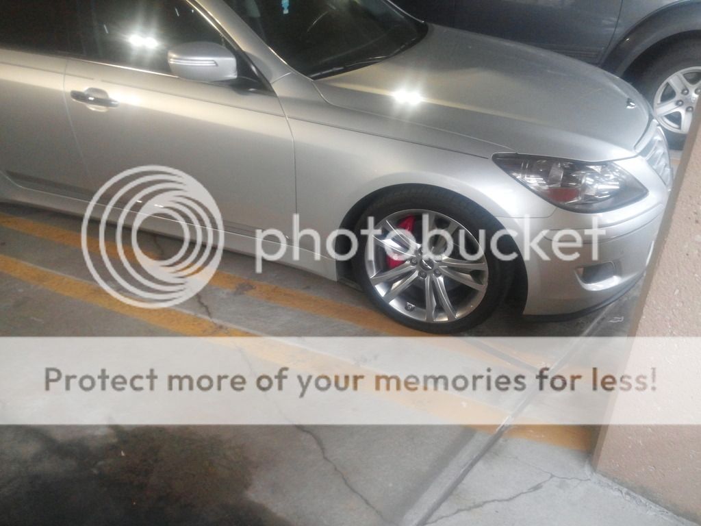

Coupe Brembo Retrofit
Hard to see behind the OEM 18s:
Initial impressions: A lot more confidence in braking, sharper initial "bite". As for fade resistance, we will see over the next few days, leaving out for Tennessee tomorrow morning and will play plenty on the Dragon and other driving roads in the area over the next few days.

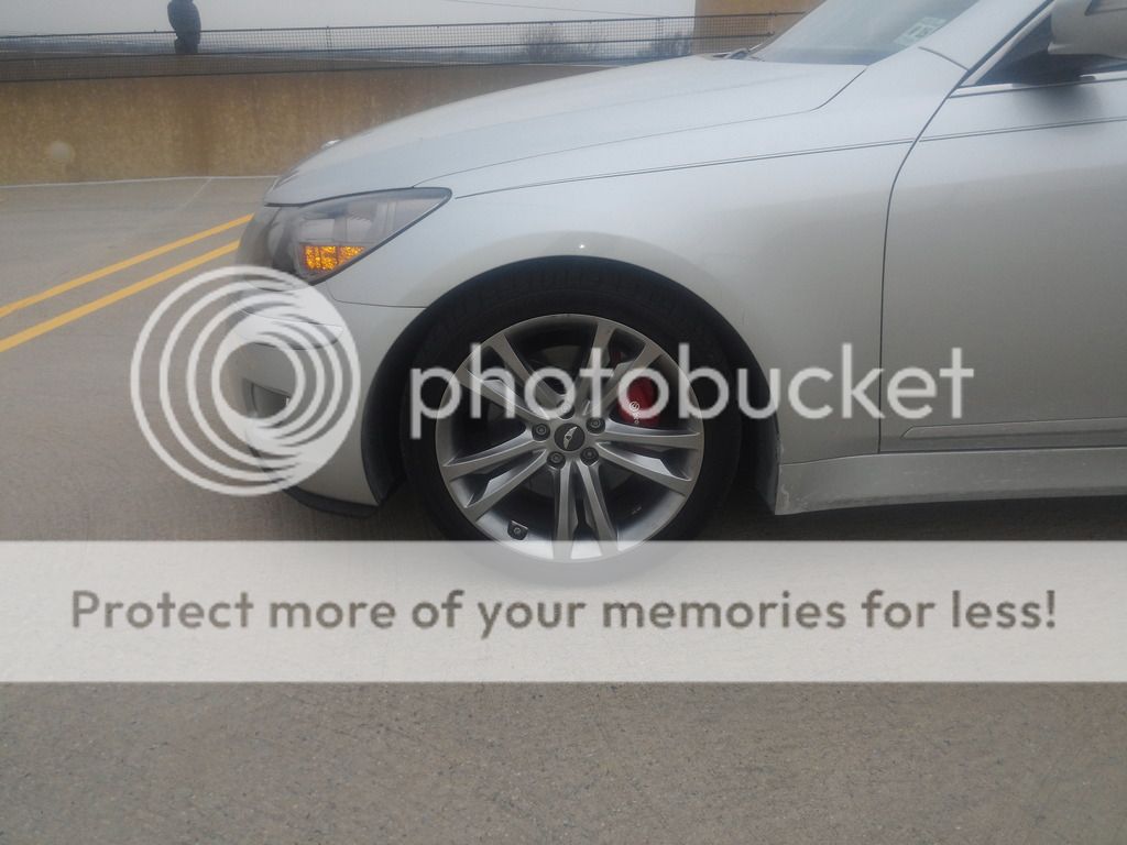

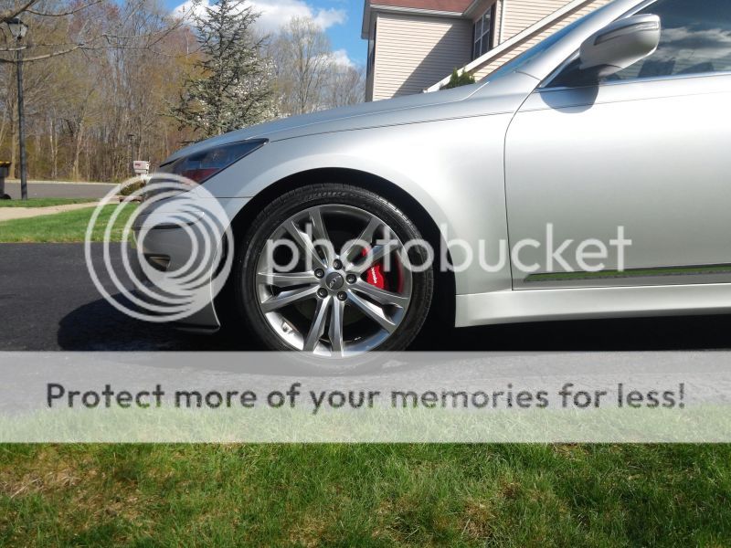

SUCCESS!
(Sorry for the dirty car and crappy pics but the rain keeps coming and going)
84Fordman thank you a million, I wouldn't even have attempted it without your instructions.
For financial reasons I didn't get SS lines or do the rears just yet. I ended up getting Powerslot rotors and HPS pads from genracer. They bite waaaay better than stock.

SUCCESS!

Looks great behind the Coupe 19s too!
