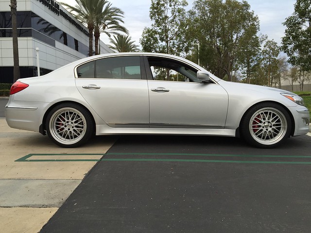

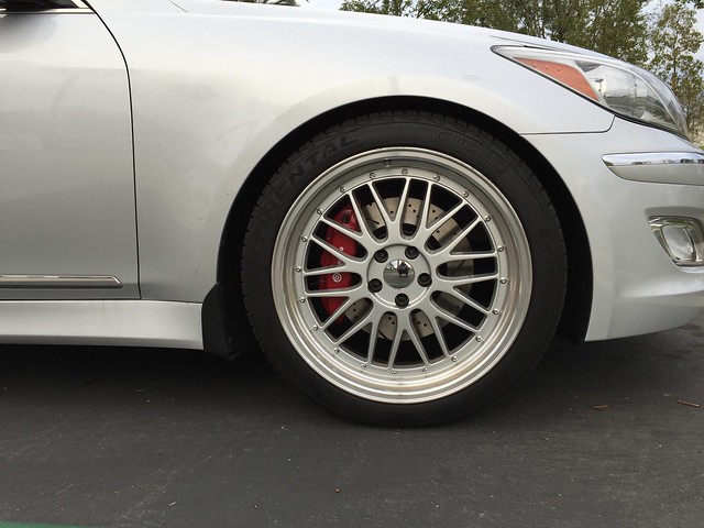

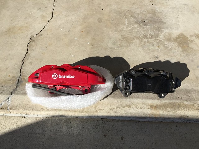

First off, thanks to Ed for this thread and all the input regarding fitment and installation. This has been on my to-do list for a while, and I actually found some time to do the install this past weekend. For the most part, the install went seamlessly (had an issue bleeding the brakes, but only because this was my first time doing it). In the end, everything works perfectly and looks great. Thought I would post a few pics.
Front Brembo vs. Mando caliper - Brembo is slightly larger, but as Ed noted, is "slimmer" than OEM which provides more wheel clearance than before

Front with wheels on after bedding pads (wheels are 20")

Whole car - might have to get new rims that show the brakes off better! :)
A couple other notes/observations to pass along:
  1. The EBC rotors were SIGNIFICANTLY lighter than the OEMs. I would say somewhere on the order of 30-40% lighter. Those OEM rotors weigh a ton!
  2. Either buy stainless coupe lines for the front or use the OEM coupe hoses. The fittings on the caliper are different between the sedan and coupe. Luckily, my Brembos came with the lines attached so I just used those.
  3. I didn't know this, but the OEM front Mando pads are "cut" to reduce noise, just like the stock pads on the coupe. I would estimate only 2/3 of pad area is actually available for braking.
Looking good!
What are your thoughts on brake feel/stopping power now?
Looking good!
Haven't had a chance to really push her too hard, but there is certainly more bite, more pedal sensitivity, and firmer/higher pedal. It took a little getting used to, but overall I would say it is much improved. :)
