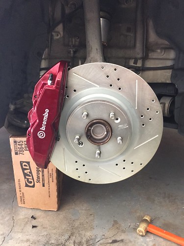

Coupe Brembo Retrofit

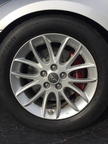

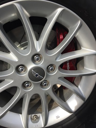

I finally got around to doing my install. Here is the end results. The calipers came off of a 2014 with 9k miles. Spent about $600. Also the rotors/brake lines/pads are all from Stop Tech.

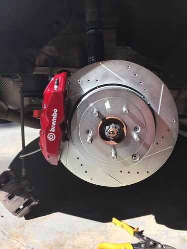

Did the swap the other weekend

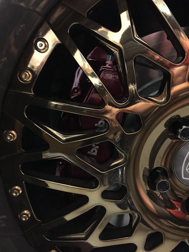

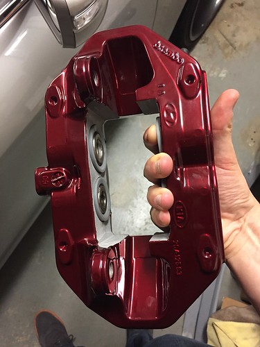

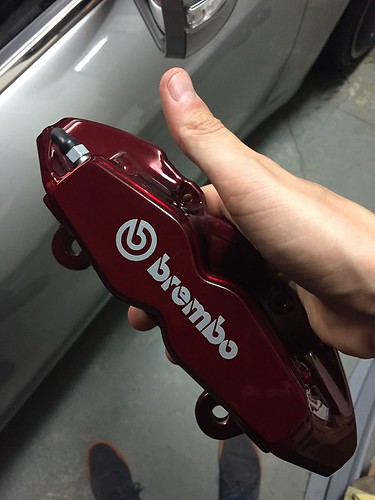

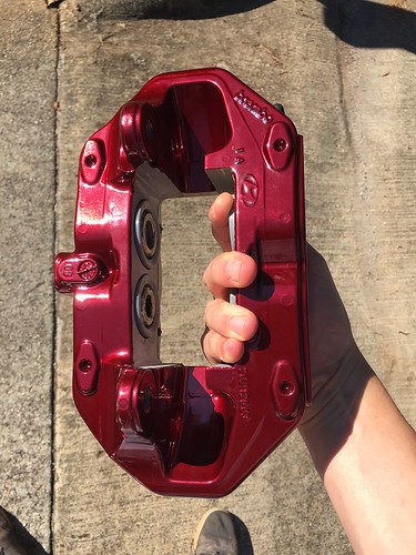

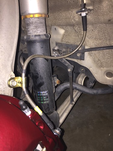

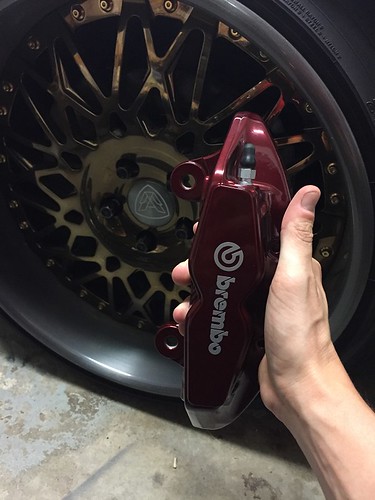

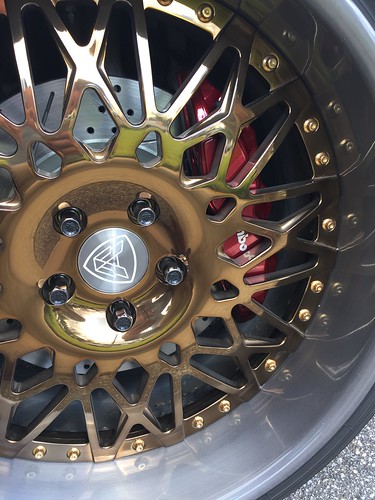

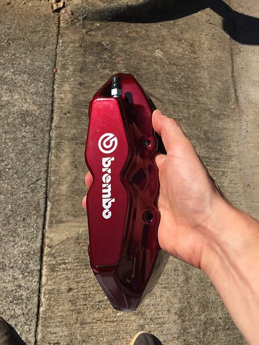

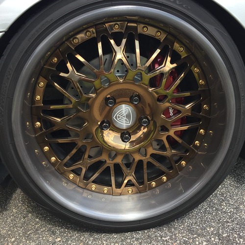

Sent my calipers off to Detective Coating for a rebuild and color change. Went with Wizard Red over Superchrome which looks more like a burgundy or dark red and really depends on the lighting. Had silver decals put on instead of white or black. No clearance issues on my Infinitewerks but did buy 20mm hubcentric spacers so I can run my OEM 17's. Really only need about 7mm spacer in the front for clearance but I only run hubcentric spacers. No side shot of the brakes installed with my Infinitewerks because I got a flat the next day.
Inside
Outside
Powerstop Extreme Drilled and Slotted rotors

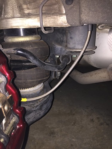

Stop Tech SS Lines
Infinitewerks
OEM 17's

Absolutely beautiful, xiaphin. If you don't mind me asking, what does a powder coating job like that cost?
Appreciate the compliment.
Through Detective Coating with core exchange it is $670. Includes stripping and powdercoating (any single or dual stage coatings offered by prismatic powders), new seals, bleeders and dustboots. Took about 1 - 1.5 weeks from the time they received my calipers.
