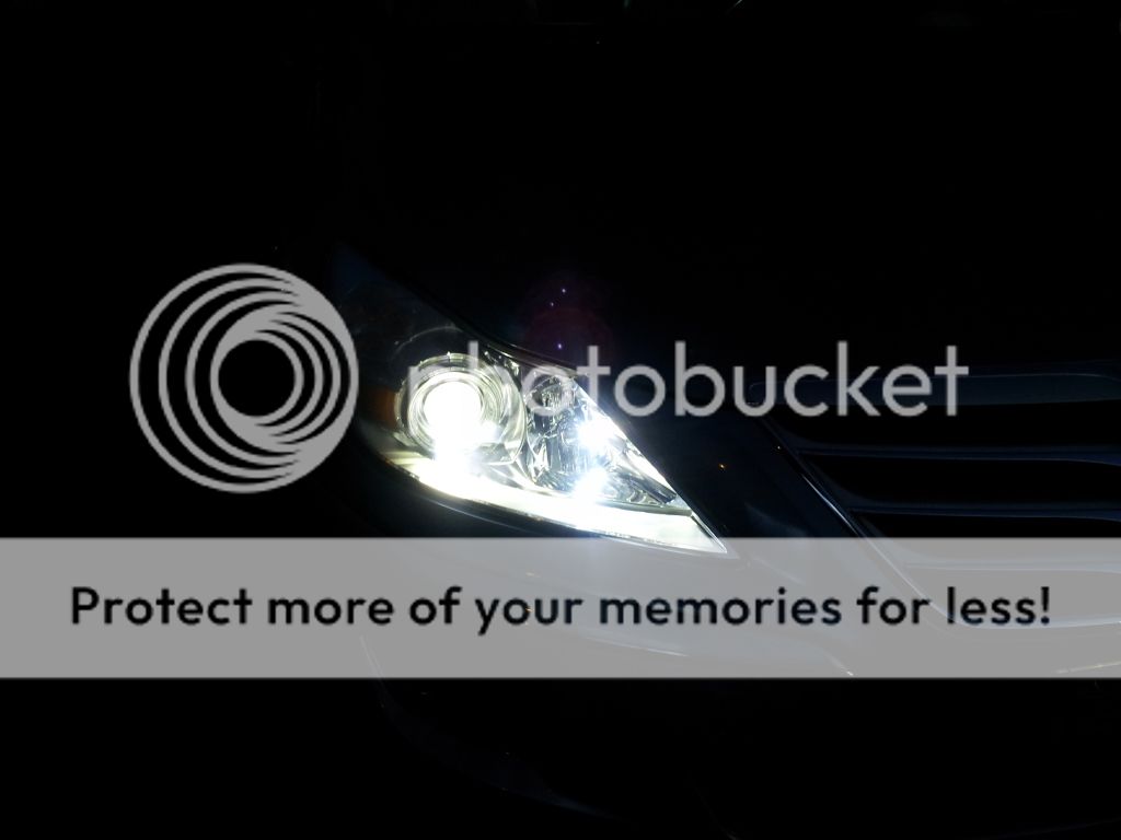

What is the bulb for the side yellow marker right near the blinker assembly? You can see it's not working with the lights on as it should be. I also just replaced the 168/194 peanut bulbs next to the high beam with Sylvania's LEDriving 1W LED ($9.99 each)...looks much better then stock bulbs. Thanks in advance !! :)
