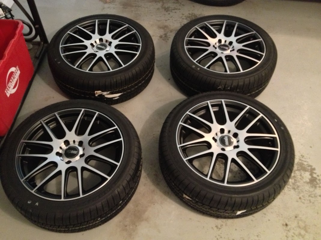

Hi, guys. Just installed some sporty 18's today. My 2012 Genesis came with the base 17" wheels so this is a substantial improvement. Not as flashy as the 19's, but I really like the new look.
Wheels: Moda MD11; 18x8; 35mm offset (Tire Rack house brand - 23.3lbs)
Tires: Goodyear RS-A High Performance All-Season (235/45r18)
OMG, 500% improvement over your factory wheels! Nice work, looks sharp:cool:
Thanks, man. Appreciate the compliment. I was definitely feeling a bit sold short with the stock wheels given this was a luxury car and my neighbor's g37 came base model with 18's. I love this car. :)
Tirerack is awesome, btw. They called me to ask if I wanted a non-OEM recommended tire size, which was a nice courtesy. Highly recommend.
I might put some Ark lowering springs on next to improve the profile.
