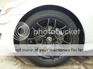

So the wheels that I ordered were back ordered. Dealer showed me a different set. Fell in love and went with them. FK Ethos Black/Ball Cut Machined 18X8 5-114.3. Weather has been crazy here lately. When the sun comes out, I'll clean her up and snap better pics.

The set you got ...... well, those black wheels really don't do justice for your car. Sorry, just my 2 cents.
I like the 2nd set. The 1st set was back ordered for who knows how long and I really didn't see anything else that I liked. I think it looks good and will look even better when the tint goes on.
