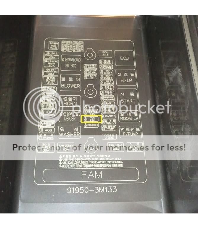

The ESC fuse is still in the engine bay on the 2012 R-Spec.
The one on the side of the dashboard is the ECS, a completely different system and disabling it is of no use here.
According the the R-Spec Owners Manual, the correct 10AMP fuse is marked VDC/ESC in the Engine Bay (not to be confused with the two 30AMP fuses marked VDC/ESC1 and VDC/ESC2)
TIM-C.. which fuse box do i find the applicable vdc/esc 10 amp fuse in ?
Im probably retarted but I just use the ESC switch. Push it and it turns it off. Isnt that the whole purpose of the switch? Is the 2012 much different from the 2011?
well not quite. here is what i did today...started car raised hood and removed
the 10 amp vdc/esc labeled fuse (from large fuse junction box to the left near firewall) and pressed the esc button inside car. replaced the fuse properly. inside car noticed that the "esc" light was lit and so was "epb" AND the "auto hold" lights. test drive was wonderful!!! no hesitating, and no tc action at all as before (i pulled fuse etc,). it is a screamer!
now, if i just press esc button only, if i am at a rolling (15mh) i see no problem with tc kicking in and stopping wheel spin. but at lower speeds or from a stop (when i floor it) , the tc takes over throwing me against the safety belt. , however, all that aside, in sport mode, the tc action does not seem to be a factor, but am checking that out.
I see you already found it, but here are a couple of photos for anyone else wondering..
