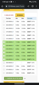

Finally got around to swapping off my OEM 19" wheel w/ studded winters to the warm-ish weather setup. I freaking LOVE this setup. I feel like a subtle 1" drop would be absolutely perfect.
Before anyone asks, I forgot the centercaps at home, but they are on now. Will snap some more pics later if you guys want em.
20x10 TSW Luco's
+40 offset
76.1 Bore
5mm Spacers all around, were required to clear the front calipers.
I feel like the machined bronze colour matches perfectly with the black chrome pieces on the car. Took me forever to pull the trigger on this due to no one having sizing / offset info. Luckily I was working with an amazing local shop willing to do all the test fitting.

How’s the drivability with these and acceleration lag since I assume these are heavier then stockFinally got around to swapping off my OEM 19" wheel w/ studded winters to the warm-ish weather setup. I freaking LOVE this setup. I feel like a subtle 1" drop would be absolutely perfect.
20x10 TSW Luco's
+40 offset
76.1 Bore
View attachment 52181View attachment 52182
Honestly... Didnt notice at all. Difference is pretty minimal i think.How’s the drivability with these and acceleration lag since I assume these are heavier then stock
That does help for sure I’ve been in between on getting rims or just powder coating my stock 19s black . Do you have the v4 or v6 modelHonestly... Didnt notice at all. Difference is pretty minimal i think.
I dont remember where i read it but i think the oem 19's are like 31 lbs each.
These wheels are 29 i think. Add on the wider tire and its maaaaaaaybe 20 lbs more?
Hope that helps!
Generally you dont want the diameter to change more than i think 1.5% from stock. My oem was 19" with 235/55/19 tires. My setup is:That does help for sure I’ve been in between on getting rims or just powder coating my stock 19s black . Do you have the v4 or v6 model
Also does it throw off your speedometer by much
