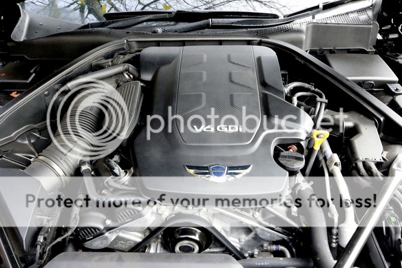

I bought 3 badges [ just in case ] one on the trunk lid, one on the engine cover.
I've got a spare trunk lid one.
Interior or exterior ?
Can you post a pic of the engine cover replacement?
Thanks
