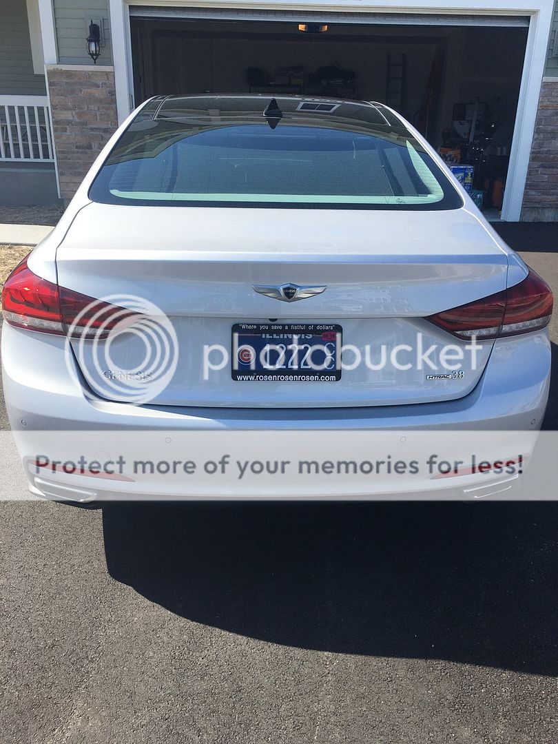

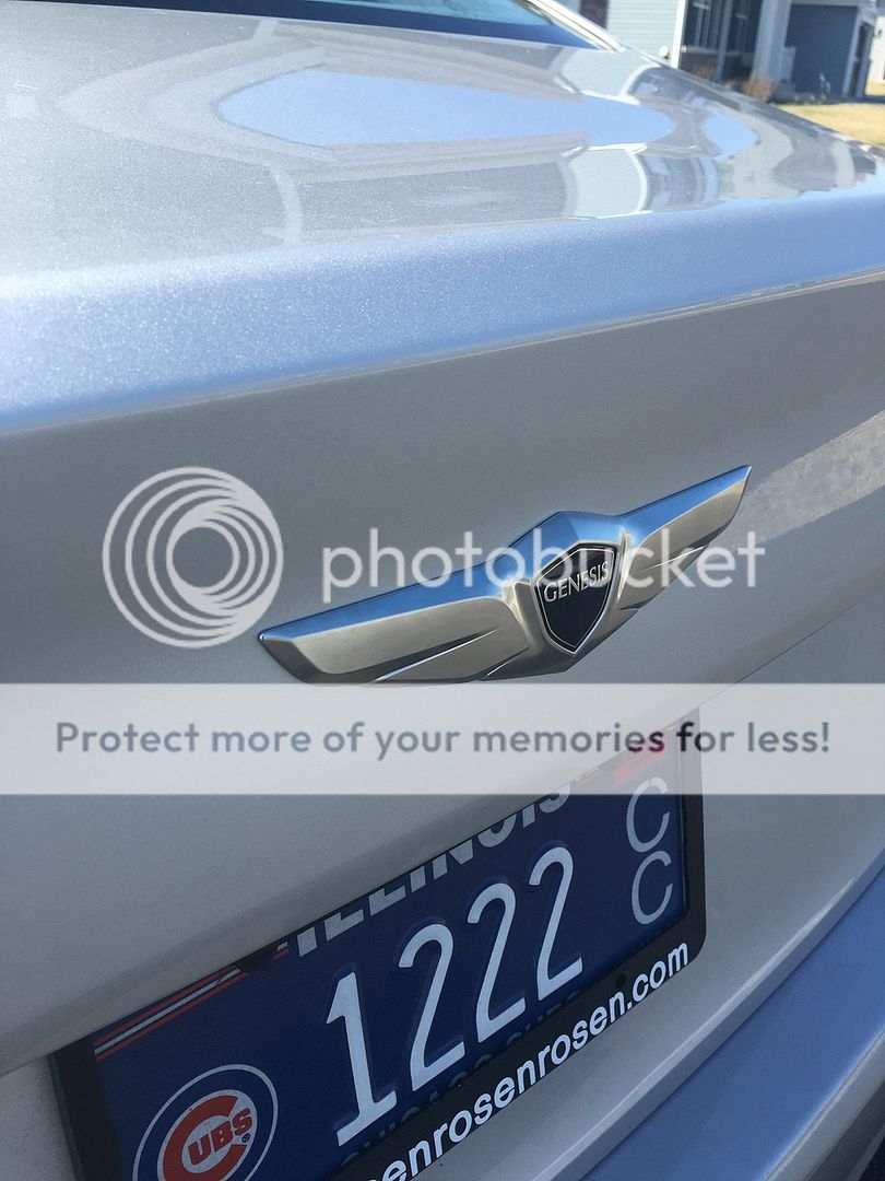

The tips of my wings are 3.5" up from the edge of the trunk lid. I found this to be the flattest spot / most OEM looking to me.
I picked my car last week and I already noticed that they screwed that up! wings are too low and 8mm off from the center.
