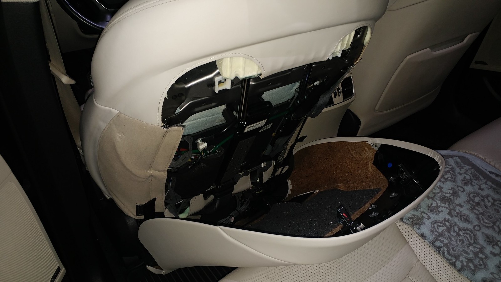

Are the cooled seats on a timer ?
I find they are effective for 4-5 mins then they seem to turn themselves off.
My cooled driver seat did the same thing. It would turn on for a few minutes and then shutoff until I turn off the car; button would not work. It happened because the rubber tube under the seat that runs up the back of the seat to the cushion vents came loose from the blower. I guess the blower has a fail safe that shuts it down for it not to burn itself out when the tubing come loose or is torn.
The seat back is easy to remove. Just pull it straight up and it comes right off. I bet your tubing is loose or torn. My hose was just disconnected. I reconnected it and the seat runs for hours at a time now during my commute.
By "seat back", you mean the whole back on which you rest comes off?
I just removed the hard plastic panel on the rear of the drivers seat. Just push it up and the clips releases.
Here is the seat back and seat cooler hose. Just pull it up. I took mine off in two seconds to take this picture.
The cooling hose is in the center and under the seat. My hose was unattached which caused my cooled seats to not work.
Thanks! The pictures helped!
No problem. A picture usually helps more than trying to explain it in words most of the time.
